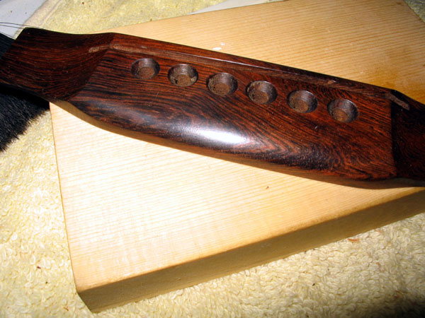

Bare wood, unfinished. Ends up looking like this:
Not a great picture, but you get the idea.Mattia Valente38851.3810185185
